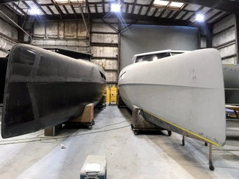

Having witnessed too many buyers in this performance catamaran segment get burned, and not wanting to be complicit in a builder abandoning yet another buyer, I quit Gunboat to oversee completion of 5508/5702 myself. We organized the tow of the boat from NC to Newport Shipyard in April. (I was tempted to go on a Tom Sawyer-type adventure and just strap a couple of outboards to the back…but…cooler heads prevailed and we took the low-risk, tow approach). For lack of a better name, we are now referring to the boat as a Man-O-War 57.
Our first step (once the boat was hauled at Newport Shipyard) was to get her leveled and on scales so there wouldn’t be any surprises later. The original Gunboat 55 was designed to be 9.5 tons but ended up nearly 50% overweight (+/- 14 tons!) and about 4 degrees stern down. When Rainmaker was launched everyone was surprised that the swim step was under water and bow was up in the air. Gunboat hastily stapled 2′ transom extensions onto the back of all 8 boats on the factory floor in an attempt to correct the trim, but it was too little, too late. We certainly didn’t want to fall into that trap. Our next step was to rip out as much weight as possible. We ditched the entire furniture package which had already been installed.
Though beautiful (and expensive) it was way too heavy and there was just WAY too much of it. We also cut out the centerboard trunks (centerboards on a performance cruising cat makes my short list of worst ideas ever). After that, we cut out the engine beds, engine hatch, aft stairs, cockpit coaming, cabin soles, etc. Once all the cutting was done we were sitting at about 4.5 tons. We are hoping to get close to the original design weight of 9.5 tons. We won’t get there, but in the immortal words of Captain Ron, “It’s important to have goals. I learned that in rehab”.
